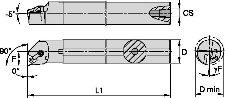

Drawings for 1098122
Material Number1098122
ISO Catalog IDA25RMTFNL16
ANSI Catalog IDA25RMTFNL16
[D] Adapter / Shank / Bore Diameter25 mm
[D] Adapter / Shank / Bore Diameter0.98 in
[DM] Minimum Bore Diameter 32 mm
[DM] Minimum Bore Diameter 1.26 in
[F] F Dimension 17 mm
[F] F Dimension 0.669 in
[L1] Tool Length 200 mm
[L1] Tool Length 7.874 in
[L] Overall Length 200 mm
[L] Overall Length 7.874 in
[LH] Head Length 41.09 mm
[LH] Head Length 1.618 in
[CS] Coolant Supply Size1/4-18 NPT
[A] Coolant Hole Diameter 6.4 mm
[A] Coolant Hole Dia 0.252 in
Gage InsertTN..160408
