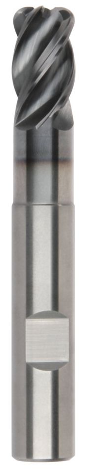

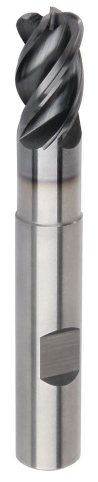

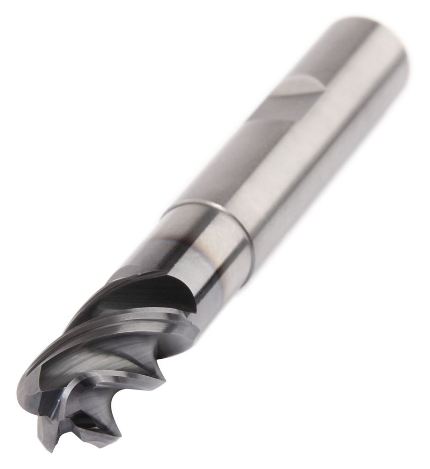

HARVI™ I • Radiused • 4 Flutes • Necked • Weldon® Shank • Metric
HARVI™ I Solid Carbide End Mill for Roughing and Finishing of Multiple Materials
Material Number4046240
ISO Catalog IDF4AS0800BWM38R050ANSI Catalog IDF4AS0800BWM38R050
HARVI™ I - Radiused - 4 Flutes - Necked - Weldon® Shank - Metric 4046240 - Kennametal
HARVI™ I - Radiused - 4 Flutes - Necked - Weldon® Shank - Metric 4046240 - Kennametal+1
$107.75/each

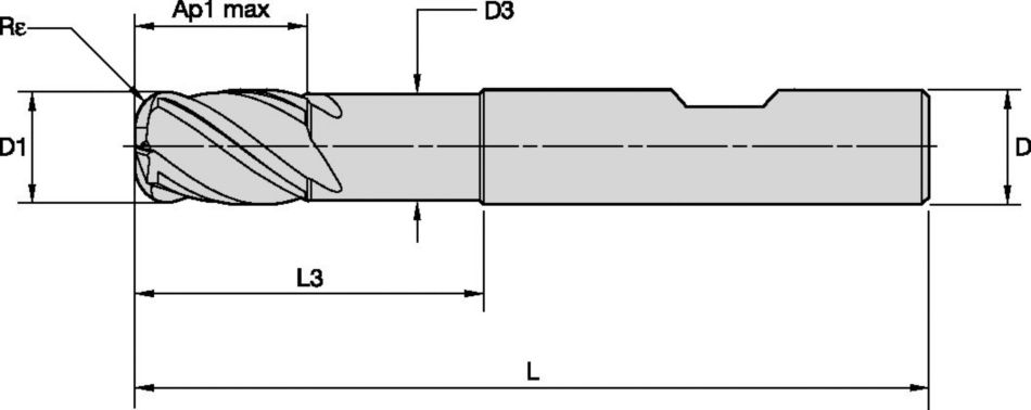

  • Tool Dimensions: Flute Configuration: 4Tool Dimensions: Flute Configuration: 4
Drawings for 4046240
GradeKCPM15
Adapter Style Machine SideWeldon
[D1] Effective Cutting Diameter8 mm
[D1] Effective Cutting Diameter0.315 in
[D] Adapter / Shank / Bore Diameter8 mm
[D] Adapter / Shank / Bore Diameter0.315 in
[D3] Neck Diameter 7.52 mm
[D3] Neck Diameter 0.2961 in
[AP1MAX] 1st Maximum Cutting Depth12 mm
[AP1MAX] 1st Maximum Cutting Depth0.4724 in
[L3] Usable Length24 mm
[L3] Usable Length0.9449 in
[L] Overall Length 68 mm
[L] Overall Length 2.6772 in
[Re] Corner Radius 0.5 mm
[Re] Corner Radius 0.02 in
[Z] Number of Flutes4
KCPM15
KCPM15
  • Versatile solid carbide end mill for steels, stainless steel, cast iron, and high temperature alloys.
  • HARVI™ I solid carbide end mills cover a variety of operations, including dynamic milling.
  • HARVI™ I solid carbide end mills features unequal flute spacing for chatter-free machining.
