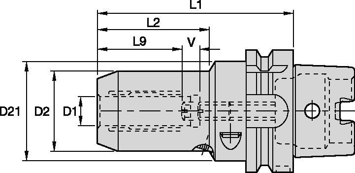

Drawings for 2229199
Material Number2229199
ISO Catalog IDHSK100AHC20150M
ANSI Catalog IDHSK100AHC20150M
[D2] Body Diameter 1 Workpiece Side 41.567 mm
[D2] Body Diameter 1 Workpiece Side 1.6365 in
[D21] Body Diameter 2 Workpiece Side62.85 mm
[D21] Body Diameter 2 Workpiece Side2.4744 in
[L1] Gage Length150 mm
[L1] Gage Length5.9055 in
[L2] Usable Length 100 mm
[L2] Usable Length 3.937 in
[L9] Clamping Length 41 mm
[L9] Clamping Hole Length 1.6142 in
[V] Adjustment Range 10 mm
[V] Adjustment Range 0.3937 in
Actuation Screw ID Drive Size5 mm
Stop Screw ID Drive Size3 mm
Weight Pounds7.3
[D1] Adapter / Shank / Bore Diameter20 mm
[D1] Adapter / Shank / Bore Diameter0.7874 in
