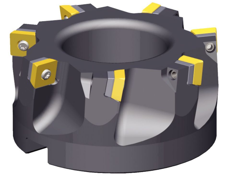

KSSM™ 12 • Shell Mill • Inch
Shoulder milling cutter for multiple materials.
Material Number1025136
ISO Catalog IDKSSISR800SD430F10ANSI Catalog IDKSSISR800SD430F10
- P Steel
- M Stainless Steel
- K Cast Iron
- N Non-Ferrous
- S High-Temp Alloys
- H Hardened Materials
- .caption
Face Milling
Slotting: Square End
Milling - Side and Face
- Overview
- Application Data
- Downloads
- Spare Parts
- Reviews
- Q&A
| Material Number | 1025136 |
| ISO Catalog ID | KSSISR800SD430F10 |
| ANSI Catalog ID | KSSISR800SD430F10 |
| [D1] Effective Cutting Diameter | 203.2 mm |
| [D1] Effective Cutting Diameter | 8 in |
| [D] Adapter / Shank / Bore Diameter | 63.5 mm |
| [D] Adapter / Shank / Bore Diameter | 2.5 in |
| [D4] Bolt Circle 4 | 101.6 mm |
| [D4] Bolt Circle 3 | 4 in |
| [D6] Hub Diameter | 155.575 mm |
| [D6] Hub Diameter | 6.125 in |
| [L] Overall Length | 60.452 mm |
| [L] Overall Length | 2.38 in |
| [AP1MAX] 1st Maximum Cutting Depth | 9.16 mm |
| [AP1MAX] 1st Maximum Cutting Depth | 0.361 in |
| Number of Inserts | 14 |
| Weight Pounds | 15.3 |
| Max RPM | 10230 |
