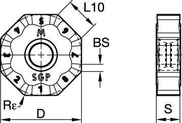

Drawings for 6406851
Material Number6406851
ISO Catalog IDONGX080620SNGP
ANSI Catalog IDONGX645SNGP
GradeKCPK30
[D] Insert IC Size20 mm
[D] Insert IC Size0.787 in
[S] Insert Thickness5.81 mm
[S] Insert Thickness0.229 in
[L10] Insert Cutting Edge Length8.28 mm
[L10] Insert Cutting Edge Length0.326 in
[Rε] Corner Radius 2 mm
[Rε] Corner Radius 0.079 in
Average Chip Thickness [HM]0.158 mm
Average Chip Thickness [HM]0.0062 in
Cutting Edges per Insert16
KCPK30
KCPK30
Coated carbide grade with CVD multilayer (TiN/TiCN/Al2O3) and advanced Beyond™ post-coat treatment. Substrate is very tough. KCPK30 has a wide application area in general and roughing milling of steels and cast irons. Performs best dry, but can also be used wet.
  • Milling insert for cast iron and compacted graphite iron (CGI) machining.
  • High-precision periphery ground insert.
  • Indexabe milling insert with sixteen cutting edges for lowest cost per edge.
  • Numbered cutting edges.
  • Low cutting forces result in smooth cutting action.
