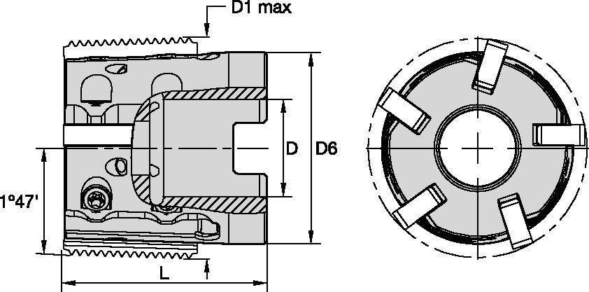

Drawings for 5593148
Material Number5593148
ISO Catalog IDTMST25D154L126Z5
ANSI Catalog IDTMST25D154L126Z5
[D1MAX] Maximum Cutting Diameter39.065 mm
[D1MAX] Maximum Cutting Diameter1.538 in
[D] Adapter / Shank / Bore Diameter12.7 mm
[D] Adapter / Shank / Bore Diameter0.5 in
[D6] Hub Diameter 34.493 mm
[D6] Hub Diameter 1.358 in
[L] Overall Length 32 mm
[L] Overall Length 1.26 in
Number of Inserts5
  • 1.478" cutting diameter.
  • For internal and external threading on most types of workpiece materials.
  • One tool is used for both right- and left-hand threads.
  • All cutters have through-coolant capability.
  • Utilizes inserts with various profiles and pitches.
