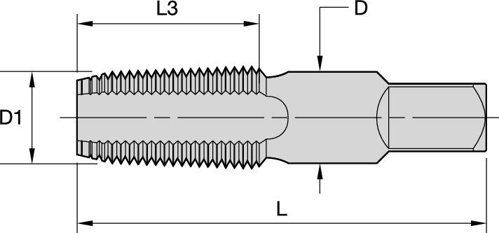

Drawings for 4130657
Material Number4130657
ISO Catalog IDKHSST28098
ANSI Catalog IDKHSST28098
CoatingUncoated
[D1-TDZ] Thread Diameter Size1/8 - 27
[L] Overall Length 53.975 mm
[L] Overall Length 2.125 in
[L3] Thread Length 19.05 mm
[L3] Thread Length 0.75 in
[D] Adapter / Shank / Bore Diameter11.113 mm
[D] Adapter / Shank / Bore Diameter0.4375 in
[Z] Number of Flutes5
Type of ThreadNPT/ANPT
  • Tapping: Pipe ThreadTapping: Pipe Thread
  • HSSHSS
  • Manufacturer’s Specs: NPTManufacturer’s Specs: NPT
  • Manufacturer’s Specs: NPTFManufacturer’s Specs: NPTF
  • Manufactured from select high-speed steel.
  • Interrupted threads to reduce drag while taper pipe threading.
  • Use where chip disposal is a concern.
  • Odd number of flutes standard.
  • NPT threads require the use of a sealer, such as Teflon® tape or pipe compound.
  • NPTF dryseal threads give a pressure-tight joint without the use of sealer.
