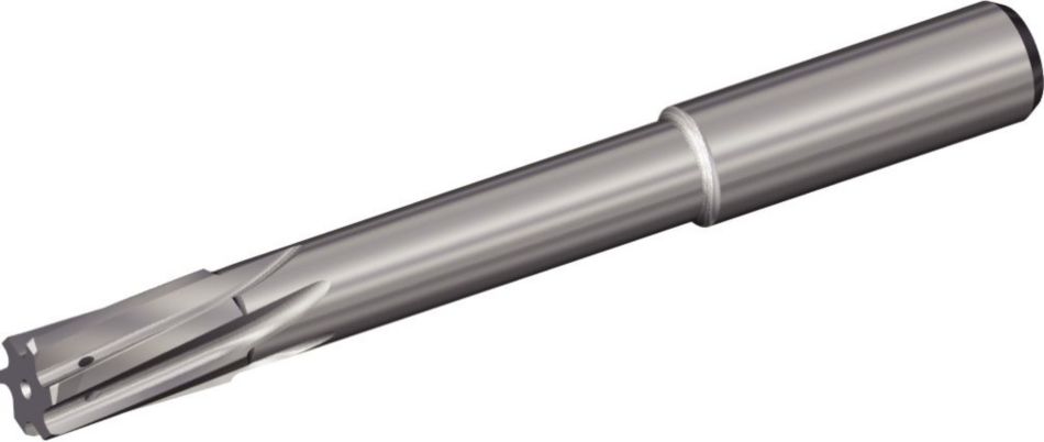

RMS with Helical Flutes and Internal Coolant
RMS™ Solid Carbide Reaming
Material Number3668912
ISO Catalog IDRMS07000H7HFANSI Catalog IDRMS07000H7HF
- P Steel
- M Stainless Steel
- K Cast Iron
- S High-Temp Alloys
Reaming: Through Hole
Reaming: Through & Cross Holes
Reaming - Through Coolant
Shank - Cylindrical Plain
| Material Number | 3668912 |
| ISO Catalog ID | RMS07000H7HF |
| ANSI Catalog ID | RMS07000H7HF |
| Grade | KC6305 |
| [D1] Reamer Diameter Minimum | 7 mm |
| [D1] Reamer Diameter Minimum | 0.2756 in |
| [D] Adapter / Shank / Bore Diameter | 8 mm |
| [D] Adapter / Shank / Bore Diameter | 0.315 in |
| [L] Overall Length | 91 mm |
| [L] Overall Length | 3.5827 in |
| [L4] Maximum Reaming Depth | 49 mm |
| [L4] Maximum Reaming Depth | 1.93 in |
| [L10] Cutting Edge Length | 16 mm |
| [L10] Cutting Edge Length | 0.6299 in |
| [Z] Number of Flutes | 4 |

KC6305
- TiAlN-PVD-coated carbide.
- Reaming grade with highly wear-resistant substrate.
- Particularly suitable for cast iron and steel.
- For exceptionally high-precision finishing.
- High-precision carbide cutting values.
- For hole tolerance H7.
- Intermediate sizes ground to achieve IT7 hole tolerance class available.
- Starting with Ø .393″ (10mm) in IT6 hole tolerance available.
