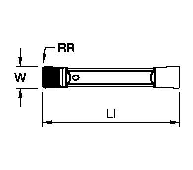

Drawings for 6888220
Material Number6888220
ISO Catalog IDA4G0400M04P04S02025ST
ANSI Catalog IDA4G0400M04P04S02025ST
GradeKBH20
Insert Size4
[W] Cutting Width 4 mm
[W] Cutting Width 0.157 in
[RR] Corner Radius0.4 mm
[RR] Corner Radius0.016 in
[LI] Insert Length 19.9 mm
[LI] Insert Length 0.783 in
[T] Cuttg Depth 3.3 mm
[T] Cutting Depth 0.13 in
