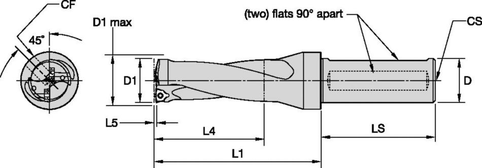

| Material Number | 1528423 |
| ISO Catalog ID | DFT2500R2SSF200 |
| ANSI Catalog ID | DFT2500R2SSF200 |
| [D] Adapter / Shank / Bore Diameter | 50.8 mm |
| [D] Adapter / Shank / Bore Diameter | 2 in |
| [D1] Drill Diameter M | 63.5 mm |
| [D1] Drill Diameter M | 2.5 in |
| [D1MAX] Drill Diameter Maximum | 67.31 mm |
| [D1MAX] Drill Diameter Maximum | 2.65 in |
| [L1] Insert Gage Length | 215.9 mm |
| [L1] Insert Gage Length | 8.5 in |
| [L4] Maximum Drilling Depth | 158.75 mm |
| [L4] Maximum Drilling Depth | 6.25 in |
| [L5] Drill Point Length | 3.173 mm |
| [L5] Drill Point Length | 0.1249 in |
| [LS] Shank Length | 101.6 mm |
| [LS] Shank Length | 4 in |
| Gage Insert | DFT0905. |

Dimension
| D | LS | CF | CS | pipe plug |
| 0.750 | 2.00 | 1/8-27 NPT | R 1/8-27 NPT | 1025612 |
| 1.000 | 3.00 | 1/8-27 NPT | R 1/4-18 NPT | 1025612 |
| 1.250 | 3.25 | 1/8-27 NPT | R 1/4-18 NPT | 1025612 |
| 1.500 | 3.75 | 1/8-27 NPT | R 1/4-18 NPT | 1025612 |
| 2.000 | 4.00 | 1/8-27 NPT | R 1/4-18 NPT | 1025612 |
