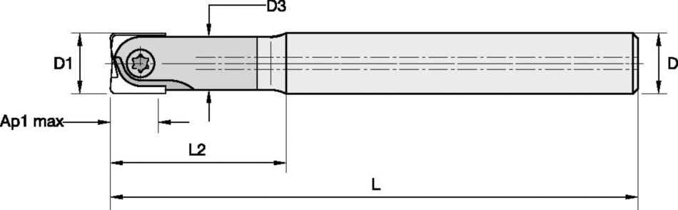

Drawings for 3964256
Material Number3964256
ISO Catalog IDKDMT10R150A10HNC
ANSI Catalog IDKDMT10R150A10HNC
[D1] Effective Cutting Diameter10 mm
[D1] Effective Cutting Diameter0.3937 in
[D] Adapter / Shank / Bore Diameter10 mm
[D] Adapter / Shank / Bore Diameter0.3937 in
[D3] Neck Diameter 8.8 mm
[D3] Neck Diameter 0.346 in
[L] Overall Length 152 mm
[L] Overall Length 5.9843 in
[L1] Gage Length152 mm
[L1] Gage Length5.9843 in
[L2] Head Length 52 mm
[L2] Head Length 2.0472 in
[AP1MAX] 1st Maximum Cutting Depth2.5 mm
[AP1MAX] 1st Maximum Cutting Depth0.0984 in
Number of Inserts1
[Z] Number of Flutes2
Coolant SupplyY
Maximum Ramping Angle3
Max RPM40000
Gage InsertKDM.10.
