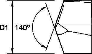

Drawings for 5397389
Material Number5397389
ISO Catalog IDKSEM1609HPGM
ANSI Catalog IDKSEM0634HPG
GradeKCPM45
[D1] Drill Diameter 16.09 mm
[D1] Drill Diameter 0.634 in
[SSC] Insert Seat Size1
