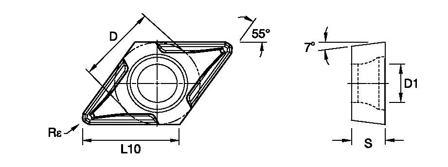

Drawings for 3751569
Material Number3751569
ISO Catalog IDDCMT11T304FW
ANSI Catalog IDDCMT3251FW
GradeKCP25
[D] Insert IC Size9.525 mm
[D] Insert IC Size0.375 in
[L10] Insert Cutting Edge Length11.628 mm
[L10] Insert Cutting Edge Length0.4578 in
[S] Insert Thickness3.97 mm
[S] Insert Thickness0.1563 in
[Rε] Corner Radius 0.4 mm
[Rε] Corner Radius 0.016 in
[D1] Insert Hole Size 4.4 mm
[D1] Insert Hole Size 0.1732 in
