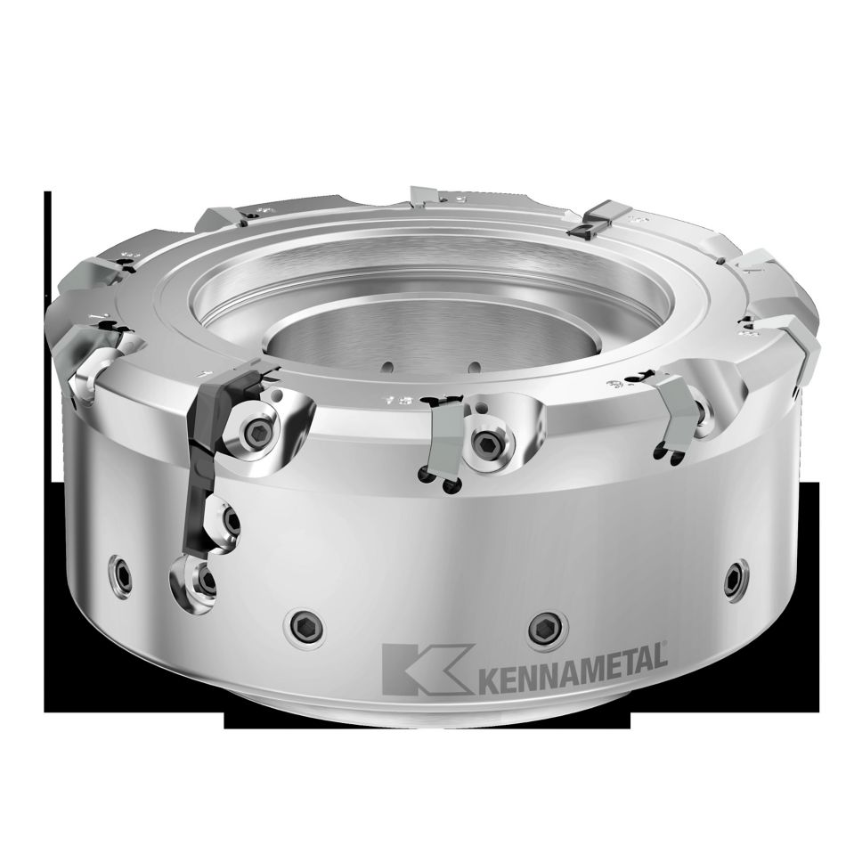

KCFM™ 45 • Shell Mill • Metric
Face Mill • Cast Iron Machining
Material Number6224239
ISO Catalog IDKCFM100R08HD07W2ANSI Catalog IDKCFM100R08HD07W2
KCFM™ 45 - Shell Mill - Metric 6224239 - Kennametal
$1,776.87/each
  • Face MillingFace Milling
Drawings for 6224239
[D1] Effective Cutting Diameter100 mm
[D1] Effective Cutting Diameter3.937 in
[D1MAX] Maximum Cutting Diameter109.53 mm
[D1MAX] Maximum Cutting Diameter4.312 in
[D] Adapter / Shank / Bore Diameter1.26 in
[D6] Hub Diameter 101.4 mm
[D6] Hub Diameter 3.992 in
[L] Overall Length 49.97 mm
[L] Overall Length 1.967 in
[AP1MAX] 1st Maximum Cutting Depth1.09 mm
[AP1MAX] 1st Maximum Cutting Depth0.043 in
Number of Inserts8
Number of Adjustable Inserts2
Weight Kilograms2.41
Max RPM8400
  • Ap1 max = 1mm with wiper finishing cartridge for SD12 inserts.
  • Ap1 max = 3mm with semi-finishing cartridge for HD07 inserts.
  • Fixed pockets for semi-finishing inserts.
  • Adjustable pockets for cartridges with finishing inserts or wiper inserts.
  • Pocket seat numbering system for quick set-up time.
