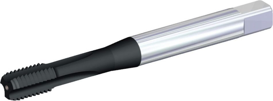

T471 • Form E Bottoming Chamfer • Through Coolant • Metric
Beyond™ Solid Carbide Straight-Flute Taps • Blind Holes
Material Number5520807
ISO Catalog IDT471M060X100R6HX-D1ANSI Catalog IDT471M060X100R6HX-D1
T471 DIN METRIC Threading - 5520807 - Kennametal
$262.93/each
  • Class of Fit: 6HXClass of Fit: 6HX
  • DIN number 371DIN number 371
  • Chamfer Form E (1.5–2)Chamfer Form E (1.5–2)
  • Through Coolant: Axial: TappingThrough Coolant: Axial: Tapping
  • HMHM
  • Tapping Helix Angle: 0°Tapping Helix Angle: 0°
Drawings for 5520807
GradeKCN14
[D1-TDZ] Thread Diameter SizeM6 X 1
[L] Overall Length 80 mm
[L] Overall Length 3.15 in
[L3] Thread Length 10 mm
[L3] Thread Length 0.39 in
[L2] Useable Length 30 mm
[L2] Useable Length 1.18 in
[D] Adapter / Shank / Bore Diameter6 mm
[D] Adapter / Shank / Bore Diameter0.2362 in
[Z] Number of Flutes3
Dimension StandardDIN 371
Thread Tolerance Class ISO6HX-I
  • HMHM
KCN14
KCN14
Coated carbide, PVD — two-layer coating over fine-grain carbide. Coating consists of low-friction CrC/C over wear-resistant TiN. CrC/C resists galling of non-ferrous materials to the tap. Provides superior performance for tapping cast aluminum and other non-ferrous materials.
  • KCN14 TiN + CrC/C for aluminum.
