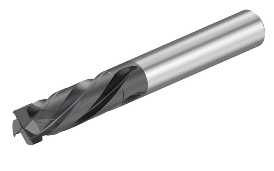

Designed to deliver the best cost per linear foot (meter), ROCO burr and down-cut routers are perfect for machining a wide range of composite materials. ROCO excels in side milling, slotting, pocketing and ramping applications. Featuring the new KCC05A grade, these tools ensure a uniform coating thickness along the tool axis, achieving sharper cutting edges, minimal wear and reduced flaking for longer tool life.
ROCO Burr Router
  • Proprietary flute design improves the distribution of forces and reduces edge chipping
  • Strong gash design produces more chips, allowing for more aggressivecutting conditions
  • Geometry pushes cutting forces both upward and downward for decreased delamination when used for side milling and slotting applications
  • Reinforced corners provide additional corner protection for longer tool life

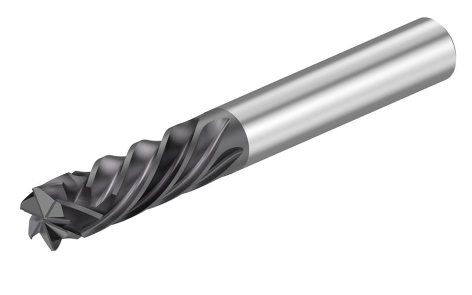

ROCO Down-Cut Router
  • Left-hand helix direction makes it ideal for pocketing applications
  • Geometry compresses fibers downward, reducing surface delamination
  • Multiple flute design increases chip load at higher material removal rates (MRR)
  • Minimizes delamination at the top of the cut, making it perfect for use on applications with sacrificial support material
  • Corner chamfers improve strength for longer tool life
Kennametal ROCO Burr Router - MM #4137733
KCC05A Grade
  • Enhanced coating adhesion ensures a longer and more consistent tool life.
  • Uniform coating thickness across the tool axis results in sharper cutting edges, minimal wear, and reduced flaking for longer tool life
