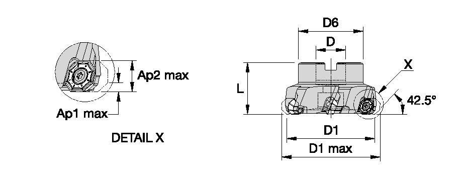

KSOM™ Mini • Shell Mill • Inch
Face milling cutter for multiple materials.
Material Number100000952
- Soft cutting action resulting in low cutting forces.
- "X" in the catalog number stands for improved finishing capabilities through a reduced axial cutting angle of 18°.
- Internal coolant supply.
Face Milling
Side Milling/Shoulder Milling: Eased Chamfer
Milling - Through Coolant
Milling - Side and Face

| D1 mm | D1 max mm | max ap mm | ramping angle (°) | ramping length mm |
| 32 | 41,1 | 9 | 11,0 | 46,3 |
| 40 | 49,0 | 9 | 7,5 | 68,4 |
| 50 | 58,9 | 9 | 5,0 | 102,9 |
| 63 | 71,8 | 9 | 3,9 | 132,0 |
| 80 | 88,7 | 9 | 2,9 | 177,7 |
| 100 | 108,6 | 9 | 2,2 | 234,3 |
| 125 | 133,6 | 9 | 1,7 | 303,2 |
| 160 | 168,5 | 9 | 1,3 | 396,6 |
| Max. DOC AP | mm | Chipload (fz) |
| Ap1 max | 3,5 | 1 x fz |
| Ap2 max | 9,0 | 0,6 x fz |
| Hole Diameter | ||||
| D1 mm | D1 max mm | min. mm | max. mm | Ap/Rev. mm |
| 32 | 41,1 | 61,7 | 81,7 | 4,7 |
| 40 | 49,0 | 77,5 | 97,6 | 4,7 |
| 50 | 58,9 | 97,4 | 117,4 | 4,7 |
| 63 | 71,8 | 123,3 | 143,3 | 4,7 |
| 80 | 88,7 | 157,2 | 177,2 | 4,7 |
| 100 | 108,6 | 197,2 | 217,1 | 4,7 |
| 125 | 133,6 | 247,1 | 267,0 | 4,7 |
| 160 | 168,5 | 317,1 | 377,0 | 4,7 |
| Max. Plunging Depth | mm |
| Ap1 max | 3,2 |
| D1 inch | D1 max inch | Ap max inch | ramping angle (°) | ramping length inch |
| 1.25 | 1.61 | .354 | 11,0 | 1.82 |
| 1.50 | 1.85 | .354 | 8,0 | 2.52 |
| 2.00 | 2.35 | .354 | 5,2 | 3.89 |
| 2.50 | 2.85 | .354 | 3,8 | 5.34 |
| 3.00 | 3.34 | .354 | 3,0 | 6.76 |
| 4.00 | 4.34 | .354 | 2,1 | 9.66 |
| 5.00 | 5.34 | .354 | 1,6 | 12.69 |
| 6.00 | 6.34 | .354 | 1,3 | 15.61 |
| max DOC Ap | inch | chipload (fz) |
| Ap1 max | .14 | 1 x fz |
| Ap2 max | .35 | 0,6 x fz |
| hole diameter | ||||
| D1 inch | D1 max inch | min inch | max inch | Ap/Rev inch |
| 1.25 | 1.61 | 2.41 | 3.20 | .185 |
| 1.50 | 1.85 | 2.91 | 3.69 | .185 |
| 2.00 | 2.35 | 3.90 | 4.68 | .185 |
| 2.50 | 2.85 | 4.93 | 5.68 | .185 |
| 3.00 | 3.34 | 5.89 | 6.68 | .185 |
| 4.00 | 4.34 | 7.89 | 8.67 | .185 |
| 5.00 | 5.34 | 9.89 | 10.67 | .185 |
| 6.00 | 6.34 | 11.89 | 12.67 | .185 |
| max plunging depth | inch |
| Ap1 max | .13 |
