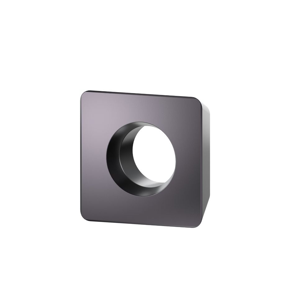

5230VS12 Series • Carbide Insert • SDMW12-TN • Heavy Machining
Shoulder milling insert with four cutting edges.
Material Number5659355
ISO Catalog IDSDMW120412TNANSI Catalog IDSDMW120412TN
5230VS12 IN SDMT12-EN423 Milling - 5659355 - Kennametal
$24.06/each
Drawings for 5659355
GradeSP6519
[D] Insert IC Size12.7 mm
[D] Insert IC Size0.5 in
[S] Insert Thickness4.76 mm
[S] Insert Thickness0.187 in
[Rε] Corner Radius 1.2 mm
[Rε] Corner Radius 0.047 in
Average Chip Thickness [HM]0.06 mm
Average Chip Thickness [HM]0.0024 in
Cutting Edges per Insert4
SP6519
SP6519
Coated carbide grade with PVD TiAlN nano-composite coating on a tough substrate. Primarily for use in general and heavy machining, dry and wet.
