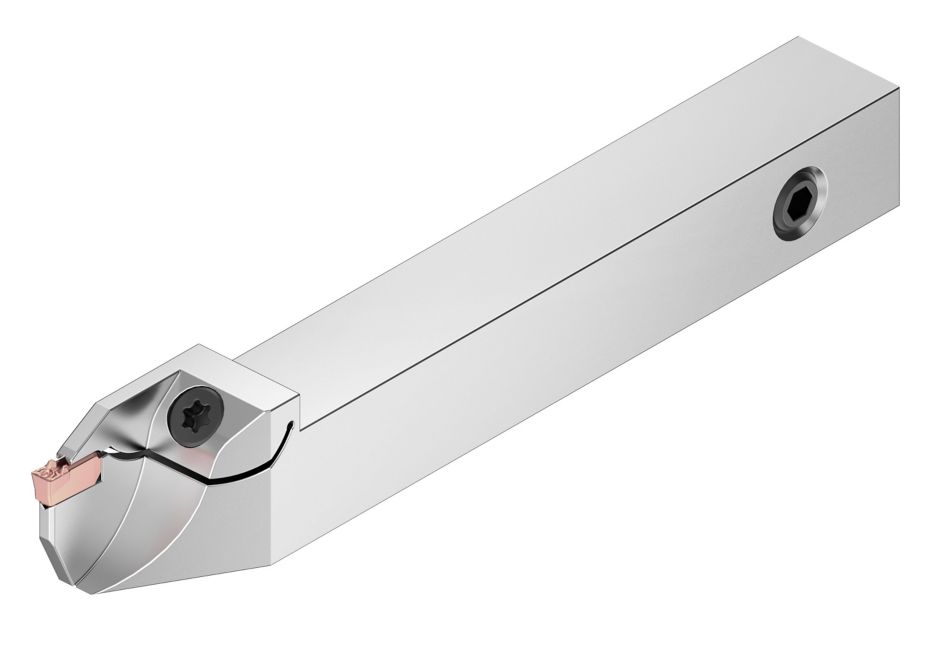

Beyond™ Evolution™ • Integral Toolholder • Reinforced • Front Clamp • Through Coolant • Metric
Grooving, and Cut-Off • Square Shank
Material Number6179933
ISO Catalog IDEVSCFL1616K0316CANSI Catalog IDEVSCFL1616K0316C
Beyond™ Evolution™ EVSCFL1616K0316C Toolholder 6179933 - Kennametal

Drawings for 6179933
Insert Size3
[CD] Cutting Depth 16 mm
[CD] Cutting Depth 0.63 in
[DMAX] Maximum Bore Diameter32 mm
[DMAX] Maximum Bore Diameter1.26 in
[H1] Cutting Height16 mm
[H1] Cutting Height0.63 in
[H] Shank Height 16 mm
[H] Shank Height 0.63 in
[B] Shank Width 16 mm
[B] Shank Width 0.63 in
[H2] Head Height 20.75 mm
[H2] Head Height 0.817 in
[L1] Tool Length 125 mm
[L1] Tool Length 4.921 in
[FS] Secondary F Dimension 14.5 mm
[FS] Secondary F Dimension 0.571 in
[LH] Head Length 27.5 mm
[LH] Head Length 1.083 in
[CS] Coolant Supply SizeM8X1
Clamp Screw ID Drive SizeT20
