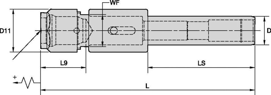

[CST] Catalog Collet SeriesL
[D11] Lock Nut Diameter37.973 mm
[D11] Lock Nut Diameter1.495 in
[L] Overall Length 190.5 mm
[L] Overall Length 7.5 in
[LS] Shank Length 95.25 mm
[LS] Shank Length 3.75 in
[L9] Clamping Length 40.386 mm
[L9] Clamping Hole Length 1.59 in
[LTN] Slide Tension 19.05 mm
[LTN] Slide Tension 0.75 in
[WF] Distance Across Flats 28.58 mm
[WF] Distance Across Flats 1.125 in
Torque Catalog Foot Pounds60
Weight Pounds2.08
