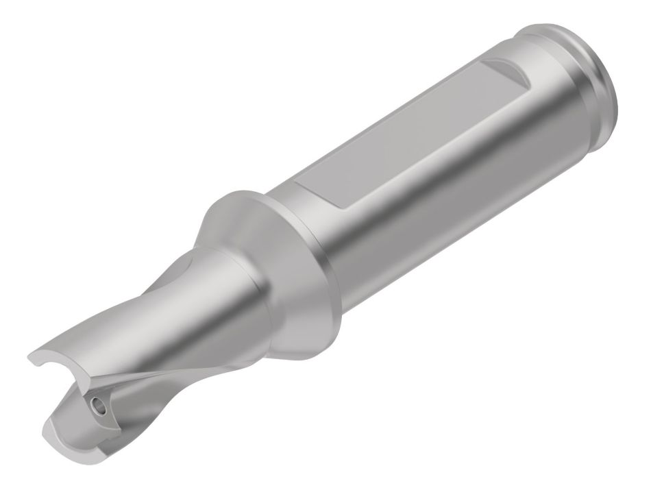

KenTIP™ FS • Drill Body • 1.5 x D • SCF Shank • Metric
Modular Drilling • Flanged Shank with Flat (SCF)
Material Number6389507
ISO Catalog IDKTFS230R01SCF25MANSI Catalog IDKTFS230R01SCF25M
KENTIP FS SCF 1xD ISO Holemaking - 6389507 - Kennametal
$492.88/each
  • Shank - Cylindrical with FlatShank - Cylindrical with Flat
Drawings for 6389507
[D1] Drill Diameter M 23 mm
[D1] Drill Diameter M 0.9055 in
[D1MAX] Drill Diameter Maximum23.999 mm
[D1MAX] Drill Diameter Maximum0.9448 in
[L4] Maximum Drilling Depth 36 mm
[L4] Maximum Drilling Depth 1.417 in
[L] Overall Length 122 mm
[L] Overall Length 4.8031 in
[LATTH] Insert Attach LG Holder52.7 mm
[LATTH] Insert Attach LG Holder2.0748 in
[L1] Insert Gage Length 66 mm
[L1] Insert Gage Length 2.5984 in
[LS] Shank Length 56 mm
[LS] Shank Length 2.2047 in
[D] Adapter / Shank / Bore Diameter25 mm
[D] Adapter / Shank / Bore Diameter0.9843 in
[SSC] Insert Seat SizeZB
  • Large, ultra-high polished chip flutes guarantee hassle-free chip evacuation, enhancing tool life and performance.
  • Coolant delivery to the drill point and to the rake face for guaranteed coolant delivery where it is needed.
  • Every drill body comes with a KenTIP FS smart wrench. Insert exchange in the machine becomes easy and saves idle time and money.
