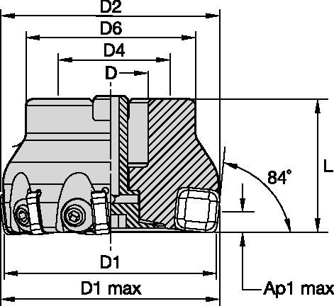

Drawings for 2465832
Material Number2465832
ISO Catalog ID125B18RF84SN12B
ANSI Catalog ID125B18RF84SN12B
[D1] Effective Cutting Diameter125 mm
[D1] Effective Cutting Diameter4.9213 in
[D1MAX] Maximum Cutting Diameter127 mm
[D1MAX] Maximum Cutting Diameter5 in
[D] Adapter / Shank / Bore Diameter1.5748 in
[D2] Maximum Body Diameter125.29 mm
[D2] Maximum Body Diameter4.9327 in
[D6] Hub Diameter 89 mm
[D6] Hub Diameter 3.5039 in
[L] Overall Length 63 mm
[L] Overall Length 2.4803 in
[AP1MAX] 1st Maximum Cutting Depth5 mm
[AP1MAX] 1st Maximum Cutting Depth0.1969 in
Number of Inserts18
Weight Kilograms3.1
Max RPM3800

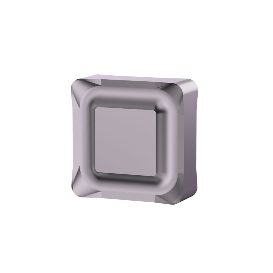

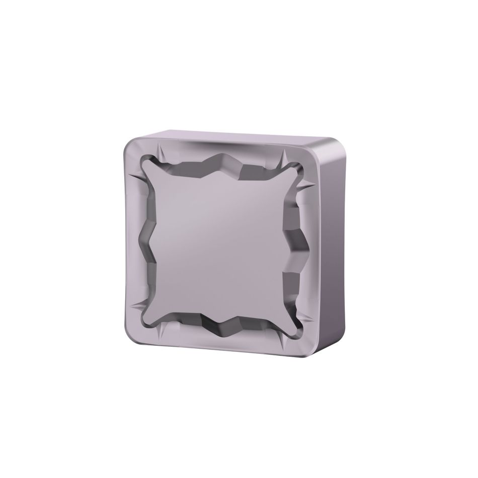

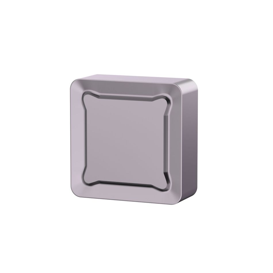

KSSR™ • Carbide Insert • SNXF-HE • Heavy Machining
KSSR™ • Carbide Insert • SNXF-GP • Medium Machining
KSSR™ • Carbide Insert • SNXF-LD • Light Machining

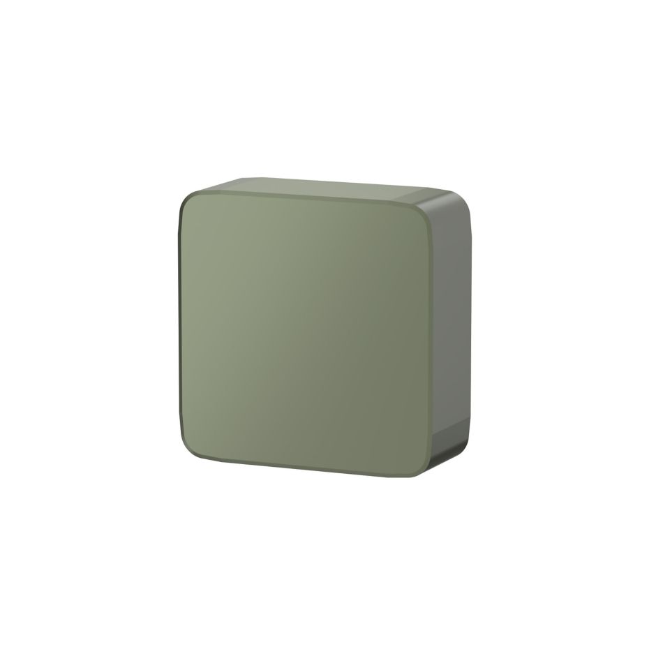

KSSR™ • Ceramic Insert • SNXF • High-Speed Machining
KSSR™ • Ceramic Wiper Insert • XNXF • High-Speed Machining
