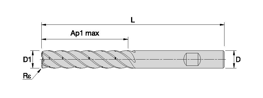

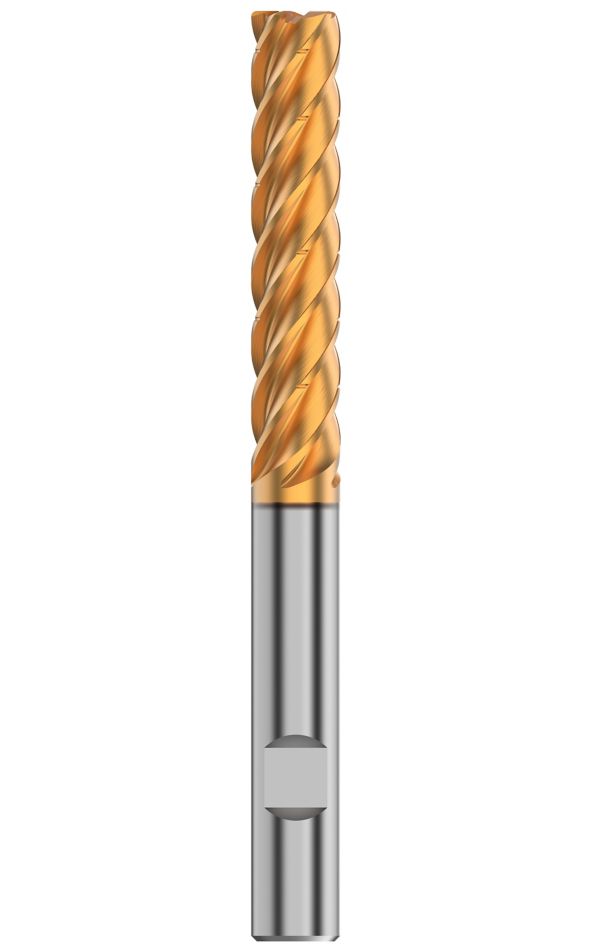

KOR5™ DS • Radiused • 5 Flutes • 5 x D • Weldon® Shank • Inch
KOR5™ DS Solid Carbide End Mill for Dynamic Milling of Steel and Stainless Steel
Numéro de matériel100159665
- Designed for trochoidal milling with low radial engagement and full length of cut.
- With chip deformers for ideal chip evacuation at high surface quality.
- Proprietary flute form reduces vibrations and improves tool life.
- Helix angle tailored to minimize vibration and optimize tool life.
- Front end geometry designed for maximum tool life in helical and ramping operations.
