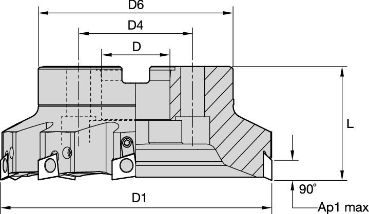

Drawings for 1758499
Material Number1758499
ISO Catalog ID200C12RP90BG15C3WPM
ANSI Catalog ID200C12RP90BG15C3WPM
[D1] Effective Cutting Diameter200 mm
[D1] Effective Cutting Diameter7.874 in
[D] Adapter / Shank / Bore Diameter60 mm
[D] Adapter / Shank / Bore Diameter2.3622 in
[D4] Bolt Circle 4101.6 mm
[D4] Bolt Circle 34 in
[D6] Hub Diameter 134 mm
[D6] Hub Diameter 5.2756 in
[L] Overall Length 63 mm
[L] Overall Length 2.4803 in
[AP1MAX] 1st Maximum Cutting Depth9.5 mm
[AP1MAX] 1st Maximum Cutting Depth0.374 in
Number of Inserts12
Number of Adjustable Inserts3
Weight Kilograms6
Max RPM6366
