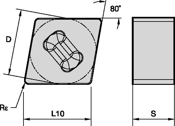

Kendex™ • Negative Inserts • CNGX
ISO Turning Insert • Negative C-Style
Material Number1183552
ISO Catalog IDCNGX120716T02020ANSI Catalog IDCNGX454T0820
- K Cast Iron
| Material Number | 1183552 |
| ISO Catalog ID | CNGX120716T02020 |
| ANSI Catalog ID | CNGX454T0820 |
| Grade | KY3500 |
| [D] Insert IC Size | 12.7 mm |
| [D] Insert IC Size | 0.5 in |
| [L10] Insert Cutting Edge Length | 12.896 mm |
| [L10] Insert Cutting Edge Length | 0.5077 in |
| [S] Insert Thickness | 7.94 mm |
| [S] Insert Thickness | 0.3125 in |
| [Rε] Corner Radius | 1.6 mm |
| [Rε] Corner Radius | 0.063 in |
- Cast Iron
KY3500
A ceramic cutting material based on micro-grain Si3N4 primarily for use in light to general machining of gray cast iron and ferritic ductile cast iron. Dry machining is recommended.
