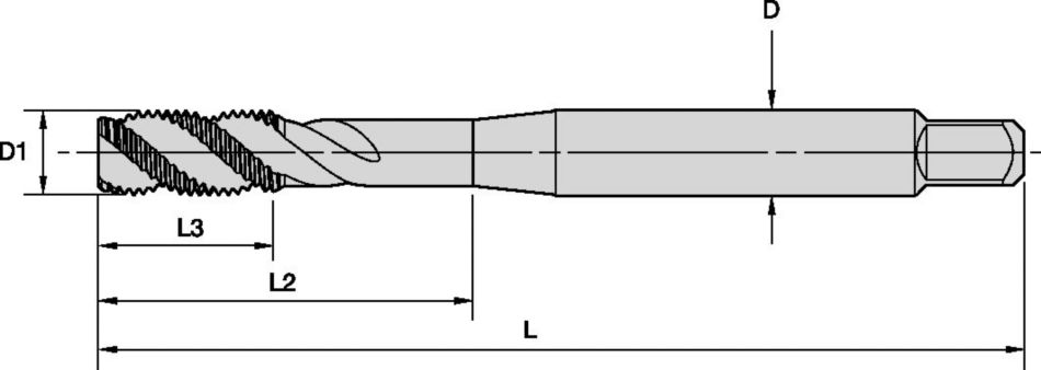

Drawings for 6173261
Material Number6173261
ISO Catalog IDT838NC#06-32R2B-D1
ANSI Catalog IDT838NC#06-32R2B-D1
GradeKSU31
[D1-TDZ] Thread Diameter Size#6 - 32
[L] Overall Length 56 mm
[L] Overall Length 2.2 in
[L3] Thread Length 7 mm
[L3] Thread Length 0.28 in
[L2] Useable Length 20.7 mm
[L2] Useable Length 0.81 in
[D] Adapter / Shank / Bore Diameter4 mm
[D] Adapter / Shank / Bore Diameter0.157 in
[Z] Number of Flutes3
Dimension StandardDIN 371
Thread Tolerance Class ANSI2B

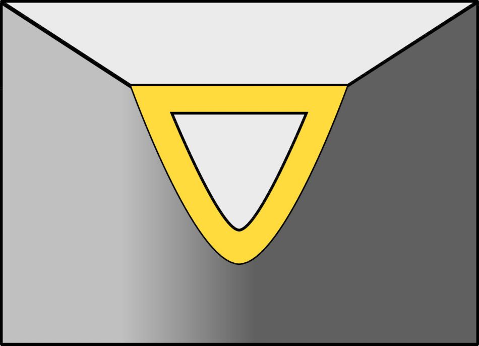

Coated HSS-E substrate with TiN PVD layer. Use in multiple applications, including steel, stainless steel, ductile cast iron, and cast aluminum.
  • KSU31 TiN
  • KSP39 oxide
