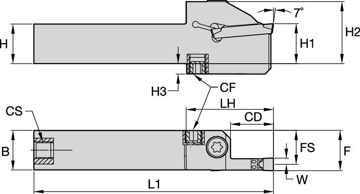

Drawings for 7110754
Material Number7110754
ISO Catalog IDA4SML120214C
ANSI Catalog IDA4SML120214C
Insert Size2
[CD] Cutting Depth 14 mm
[CD] Cutting Depth 0.5512 in
[W] Groove Width 2 mm
[W] Groove Width 0.0787 in
[H] Shank Height 19.05 mm
[H] Shank Height 0.75 in
[H1] Cutting Height19.05 mm
[H1] Cutting Height0.75 in
[H2] Head Height 32.35 mm
[H2] Head Height 1.2736 in
[H3]Head Bottom Offset 5 mm
[H3]Head Bottom Offset 0.1969 in
[B] Shank Width 19.05 mm
[B] Shank Width 0.75 in
[L1] Tool Length 114.3 mm
[L1] Tool Length 4.5 in
[F] F Dimension 19.084 mm
[F] F Dimension 0.7513 in
[FS] Secondary F Dimension 18.084 mm
[FS] Secondary F Dimension 0.712 in
[LH] Head Length 33.8 mm
[LH] Head Length 1.3307 in
[CS] Coolant Supply SizeM8 X 1P
Clamp Screw ID Drive Size25IP
