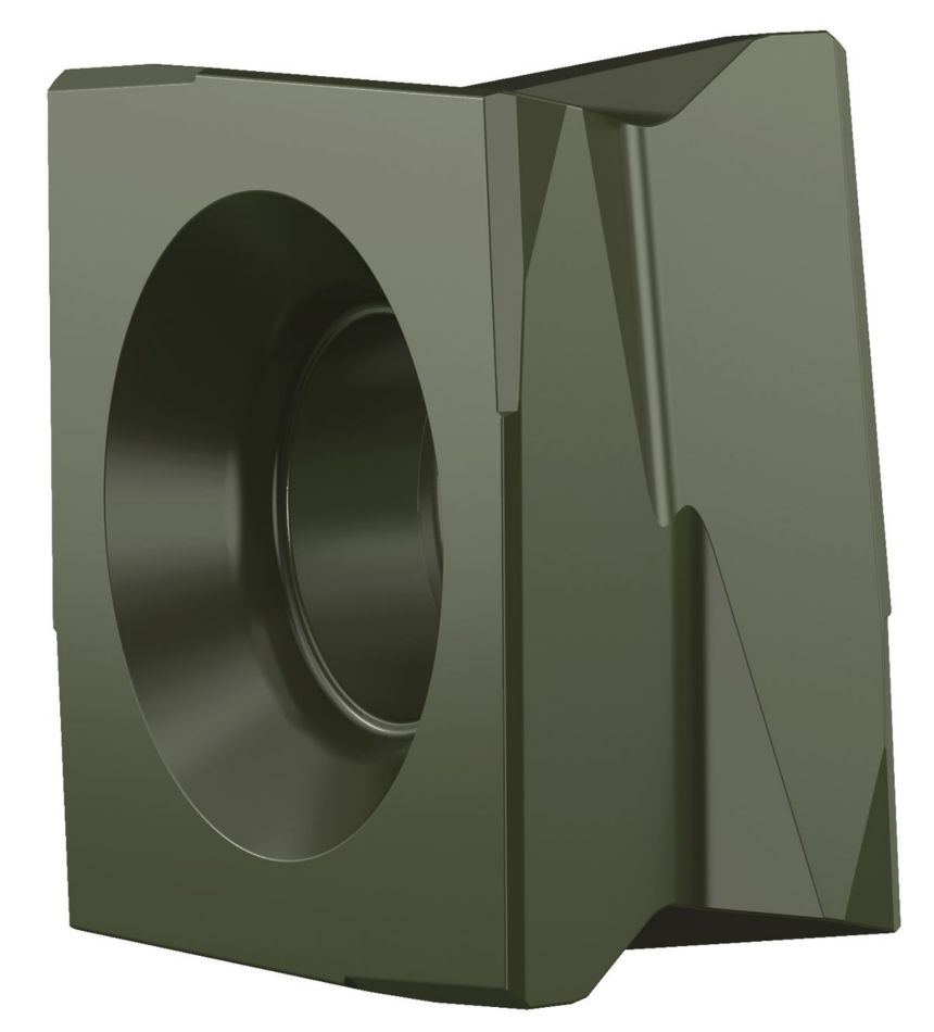

Fix-Perfect™ 90°/0° Cast Iron Series • Milling Insert • Left Handed • SPHX-GPB • Medium Machining
Face milling insert with eight cutting edges, precision ground.
Material Number1874234
ISO Catalog IDSPHX1205PCTLGPBKANSI Catalog IDSPHX1205PCTLGPBK
    GradeKY3500
    [S] Insert Thickness5.5 mm
    [S] Insert Thickness0.2165 in
    [BS] Corner Facet Length 0.7 mm
    [BS] Corner Facet Length 0.0276 in
    Average Chip Thickness [HM]0.24 mm
    Cutting Edges per Insert8
    KY3500
    KY3500
    A ceramic cutting material based on micro-grain Si3N4 primarily for use in light to general machining of gray cast iron and ferritic ductile cast iron. Dry machining is recommended.
    • Precision ground insert for best run-out and surface finish.
    • Milling insert for cast iron and compacted graphite iron (CGI) machining.
