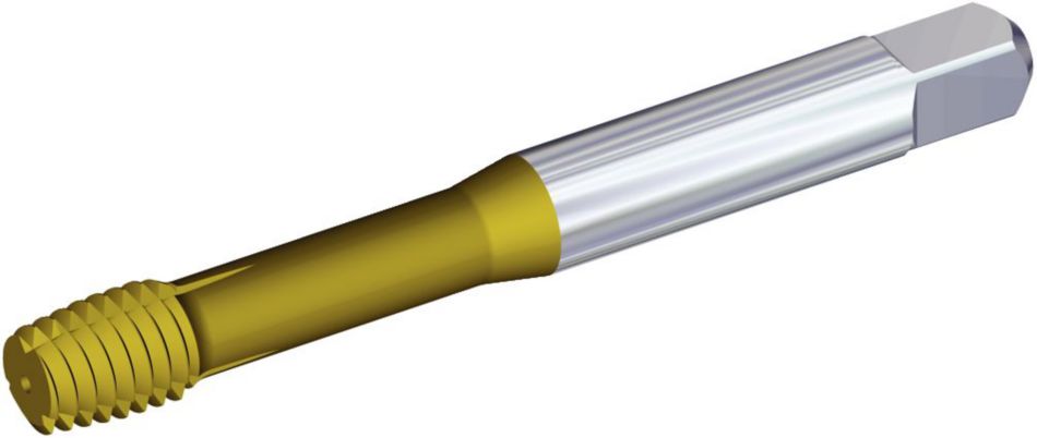

KHSST FORM • Machine Screw and Fractional • Bottoming Chamfer
Forming Taps • Blind Holes in General Machining Applications
Material Number1543620
ISO Catalog IDKHSST10117ANSI Catalog IDKHSST10117

Drawings for 1543620
CoatingUncoated
[D1-TDZ] Thread Diameter Size1/2 - 13
[L] Overall Length 85.852 mm
[L] Overall Length 3.38 in
[L3] Thread Length 23.813 mm
[L3] Thread Length 0.9375 in
[D] Adapter / Shank / Bore Diameter9.322 mm
[D] Adapter / Shank / Bore Diameter0.367 in
[Z] Number of Flutes4
Number of Lube Grooves4
Tap Pitch Diameter LimitH8
Type of ThreadNC/UNC/UNJC
  • HSSHSS
  • Chamfer Form C (2–3)Chamfer Form C (2–3)
  • Manufacturer’s Specs: UNFManufacturer’s Specs: UNF
  • Manufacturer’s Specs: UNCManufacturer’s Specs: UNC
