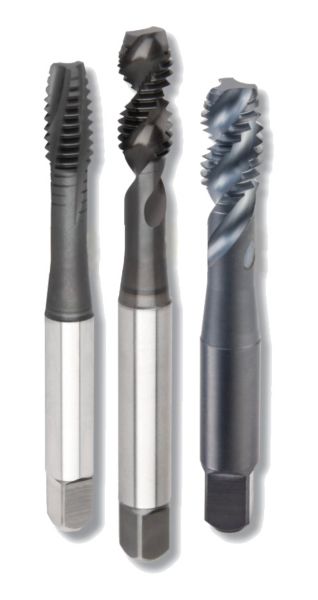

Kennametal spiral flute taps
Kennametal spiral flute taps offer high performance for blind-hole applications in steel & steel alloys, stainless steel, cast iron, nickel- & cobalt-based alloys, titanium & titanium alloys, aluminum, and hard steel.
