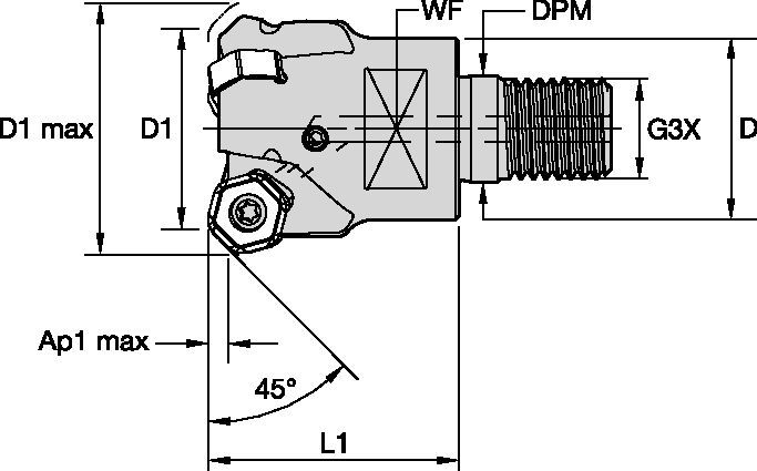

- Dodeka™ Mini 45° • Fresa de topo • Screw-On • Métrico
Fresa de facear para vários materiais
Características e benefícios
- Fornecimento de refrigeração interna.
Usos e aplicações
Fresamento de face
Fresamento lateral/fresamento de canto: chanfro suavizado
Haste — Screw-On
Fresamento — Refrigeração interna
Light
Medium
Heavy
P1–P2 | .E..LD | KC522M | .E..LP | KC522M | .E..GP | KC522M | .S..GD | KC522M | .S..HD | KC725M |
P3–P4 | .E..LD | KCPM40 | .E..LP | KCPM40 | .E..GP | KCPM40 | .S..GD | KCPK30 | .S..HD | KCPK30 |
P5–P6 | .E..LD | KCPM40 | .E..LP | KCPM40 | .E..GP | KCPM40 | .S..GD | KCPM40 | .S..HD | KCPM40 |
M1–M2 | .E..LD | KC522M | .E..LM | KC522M | .E..GM | KCSM40 | .S..GD | KCSM40 | .S..HD | KCSM40 |
M3 | .E..LD | KCSM40 | .E..LM | KCSM40 | .E..GM | KCSM40 | .S..GD | KCSM40 | .S..HD | KCPM40 |
K1–K2 | .E..LD | KCK20B | .E..LP | KCK20B | .E..LP | KCK20B | .S..GD | KCK15 | .S..HD | KCK15 |
K3 | .E..LD | KCKP10 | .E..LP | KCPK30 | .E..LP | KCPK30 | .S..GD | KCK20B | .S..HD | KCPK30 |
N1–N2 | .F..LDJ | KC410M | .F..LDJ | KC410M | .F..LDJ | KC410M | .F..LDJ | KC410M | .E..LD | KCKP10 |
N3 | .F..LDJ | KC410M | .F..LDJ | KC410M | .F..LDJ | KC410M | .F..LDJ | KC410M | .E..LD | KCKP10 |
S1–S2 | .E..LD | KC725M | .E..LM | KCSM40 | .E..GM | KCSM40 | .S..GD | KC725M | .S..HD | KC725M |
S3 | .E..LD | KCSM40 | .E..LM | KCSM40 | .E..GM | KCSM40 | .S..GD | KCSM40 | .S..HD | KCSM40 |
S4 | .E..LD | KCSM40 | .E..LM | KCSM40 | .E..GM | KCSM40 | .S..GD | KCSM40 | .S..HD | KCSM40 |
H1 | .E..LD | KCKP10 | – | – | .E..GP | KC522M | – | – | – | – |
