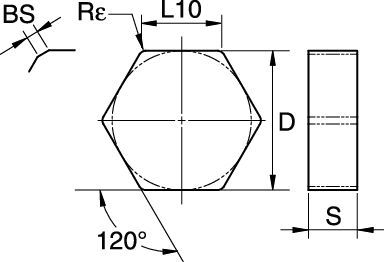

Número de material | 2240426 |
ID do catálogo ISO | HNEN0905XNSN |
ID do catálogo ANSI | HNEN0905XNSN |
Grade | KY3500 |
[D] Insert IC Size | 16.2 mm |
[D] Insert IC Size | 0.638 in |
[S] Insert Thickness | 5.56 mm |
[S] Insert Thickness | 0.219 in |
[L10] Insert Cutting Edge Length | 9.353 mm |
[L10] Insert Cutting Edge Length | 0.3682 in |
[BS] Corner Facet Length | 1.3 mm |
[BS] Corner Facet Length | 0.051 in |
Average Chip Thickness [HM] | 0.203 mm |
Average Chip Thickness [HM] | 0.008 in |
Cutting Edges per Insert | 12 |
