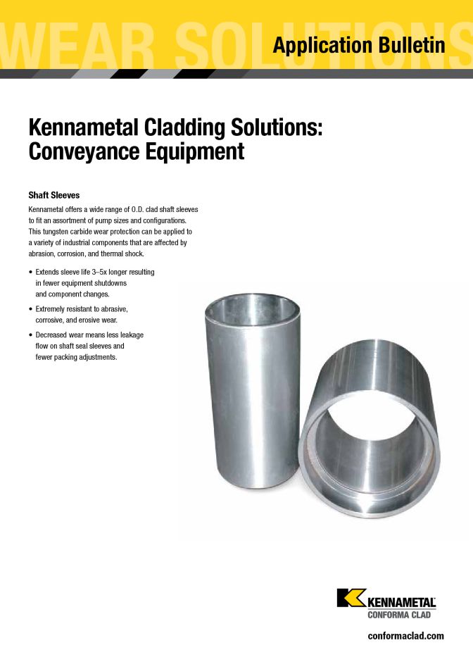

Kennametal also offers cladding solutions for a variety of conveyance equipment including:
  • Conveyance piping
  • Chutes and reducers
  • Rotary airlocks
  • Cyclone components
