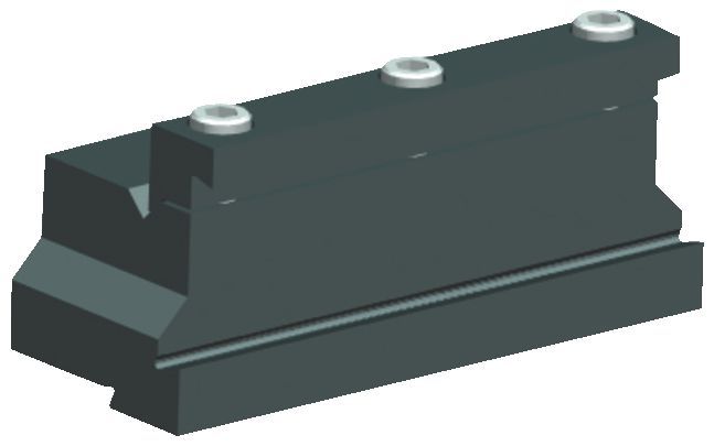

A2TE - Integral Clamp
A2™ Cut-Off Tool Blocks
Material Number1878096
ISO Catalog IDA2TZN3225J32ANSI Catalog IDA2TZN3225J32
A2T Turning - 1878096 - Kennametal
C$503.41/each
    Drawings for 1878096
    [HW] Shank Height 32 mm
    [HW] Shank Height 1.2598 in
    [H] Shank Height 32 mm
    [H] Shank Height 1.2598 in
    [B] Shank Width 25 mm
    [B] Shank Width 0.9843 in
    [F] F Dimension 36.5 mm
    [F] F Dimension 1.437 in
    [H2] Overall Height 49.5 mm
    [H2] Overall Height 1.95 in
    [B2] Overall Width 42 mm
    [B2] Overall Width 1.6535 in
    [H3] Head Bottom Offset 3 mm
    [H3] Head Bottom Offset 0.1181 in
    [L] Overall Length 110 mm
    [L] Overall Length 4.3307 in
    Clamp Screw ID Drive Size5 mm
