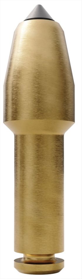

Rotating Tungsten Carbide Pick • 19mm (.74 in) Shank
External Retainer for Maximum Attachment • Plug Tip for Hard Cutting
Material Number1010804
ISO Catalog IDC21RHDANSI Catalog IDC21RHD
    GradeK3560
    Point Included Angle [SIGMA]75
    [TD] Tip Diameter12.217 mm
    [TD] Tip Diameter0.481 in
    [TL] Tip Length20.599 mm
    [TL] Tip Length0.811 in
    [L1] Gage Length45.432 mm
    [L1] Gage Length1.7887 in
    [D2] Body Diameter Workpiece Side26.975 mm
    [D2] Body Diameter Workpiece Side1.062 in
    [D] Shank/Bore Diameter18.669 mm
    [D] Shank/Bore Diameter0.735 in
    [LRO] Retainer Offset Length47.587 mm
    [LRO] Retainer Offset Length1.8735 in
    [LS] Shank Length 54.953 mm
    [LS] Shank Length 2.1635 in
    [OAL] Overall Length100.385 mm
    [OAL] Overall Length3.9522 in
