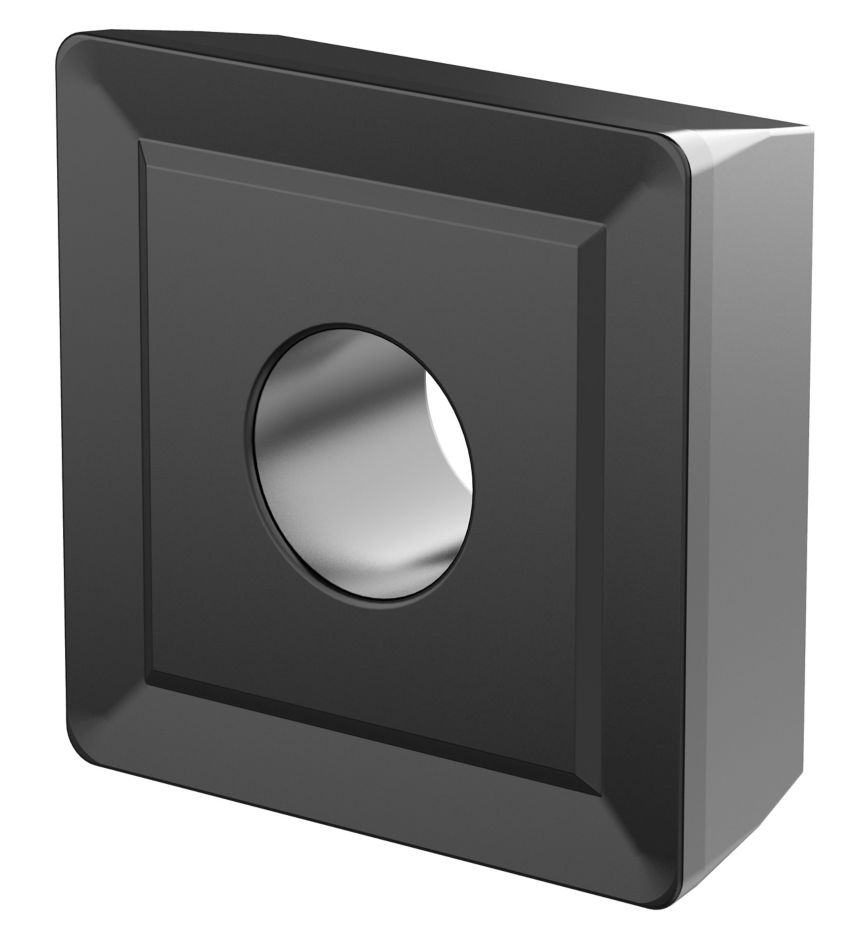

Material Number1848599
ISO Catalog IDSPGX070304FP
ANSI Catalog IDSPGX070304FP
GradeKC7215
[D] Insert IC Size7.95 mm
[D] Insert IC Size0.313 in
[D1] Insert Hole Size 2.85 mm
[D1] Insert Hole Size 0.112 in
[S] Insert Thickness3.18 mm
[S] Insert Thickness0.1252 in
[Rε] Corner Radius 0.4 mm
[Rε] Corner Radius 0.016 in
[GAA] Insert Rake Angle6
[Clearance Angle Major7
Clearance Angle Major Second11
KC7215
KC7215
Composition: PVD TiAlN coated fine-grain carbide.
Application: Best suited for machining of alloyed steel and cast iron. This grade offers reliable performance at intermediate cutting conditions.
  • Four cutting edges per insert
  • High positive chipbreaker geometry preferred for use on ductile and normal chipping materials
  • Additional inserts with increased corner radius support use with Beyond™ grades
