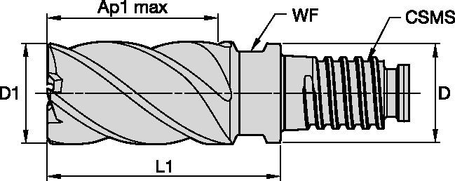

  • Tool Dimensions: Flute Configuration: 5Tool Dimensions: Flute Configuration: 5
Drawings for 6072202
Material Number6072202
ISO Catalog IDUCDV0750Y5CU
ANSI Catalog IDUCDV0750Y5CU
GradeKCPM15
Adapter Style Machine SideDUO-LOCK
[D] Adapter / Shank / Bore Diameter18.55 mm
[D] Adapter / Shank / Bore Diameter0.7307 in
[AP1MAX] 1st Maximum Cutting Depth28.575 mm
[AP1MAX] 1st Maximum Cutting Depth1.125 in
[L1] Gage Length42.9 mm
[L1] Gage Length1.689 in
[CSMS] System Size Machine SideDL20
[WF] Width of Flat 16 mm
[WF] Width of Flat 0.6299 in
[Z] Number of Flutes5
[D1] Effective Cutting Diameter19.05 mm
[D1] Effective Cutting Diameter0.75 in
KCPM15
KCPM15
  • Unequal flute spacing and variable helix configuration minimize chatter and harmonics for smoother machining.
  • Non-center cutting.
  • Ramping up to 3°.
  • Five-flute geometry able to slot up to 1 x D.
  • Single tool for both roughing and finishing, reducing setups.
