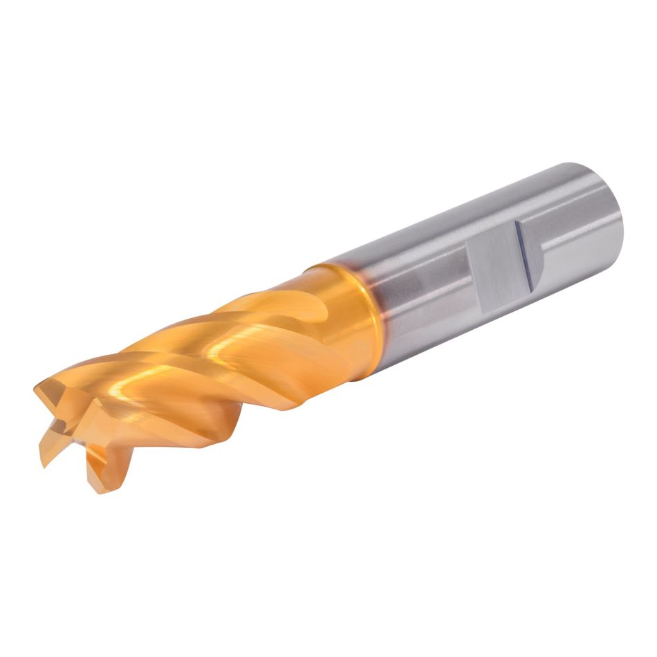

GOmill™ PRO • Chamfered • 4 Flutes • Necked • Weldon Shank • Metric
Solid Carbide End Mill for Roughing and Finishing of Multiple Materials

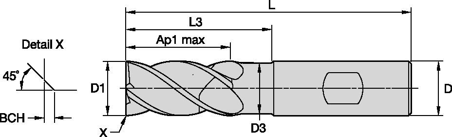

Material Number7231191
ISO Catalog IDGOPR4CH1600N032HBM
ANSI Catalog IDGOPR4CH1600N032HBM
GradeKCU20
Adapter Style Machine SideWeldon
[D1] Effective Cutting Diameter16 mm
[D1] Effective Cutting Diameter0.6299 in
[D3] Neck Diameter 15.04 mm
[D3] Neck Diameter 0.5921 in
[D] Adapter / Shank / Bore Diameter16 mm
[D] Adapter / Shank / Bore Diameter0.6299 in
[AP1MAX] 1st Maximum Cutting Depth32 mm
[AP1MAX] 1st Maximum Cutting Depth1.2598 in
[L3] Usable Length44 mm
[L3] Usable Length1.7323 in
[L] Overall Length 92 mm
[L] Overall Length 3.622 in
[BCH] Corner Chamfer Width 0.35 mm
[BCH] Corner Chamfer Width 0.0138 in
[Z] Number of Flutes4

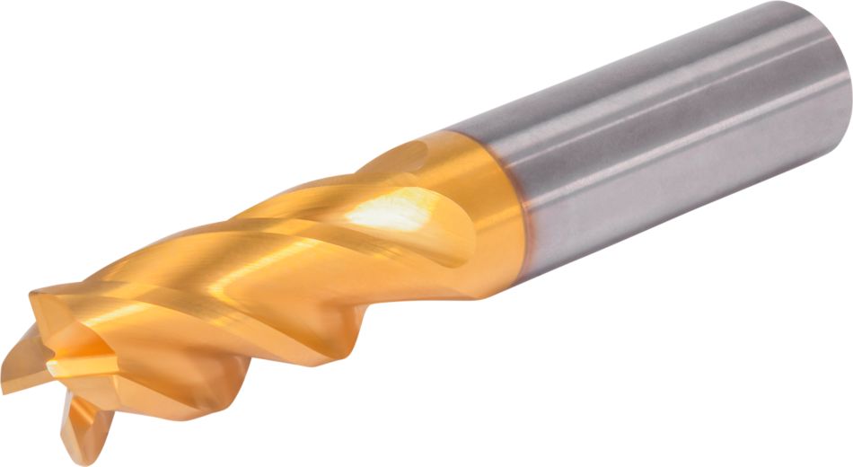

  • Asymmetric divided flute and variable helix angle for better vibration control and tool life.
  • Multilayer TiN/TiALN coating for high performance at medium-high cutting on steels, stainless steels and cast iron.
  • Ideal for shops working in the general engineering, transportation, energy and medical industries.
  • Designed for side and shoulder milling, helical milling, pocketing, slotting and ramping.
