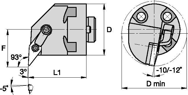

Drawings for 3612211
Material Number3612211
ISO Catalog IDH32MVUNR16
ANSI Catalog IDH32MVUNR16
[D] Adapter / Shank / Bore Diameter1.2598 in
[D2] Head Diameter 32 mm
[D2] Head Diameter 1.2598 in
[DM] Minimum Bore Diameter 43 mm
[DM] Minimum Bore Diameter 1.6929 in
[F] F Dimension 25 mm
[F] F Dimension 0.9843 in
[L1] Tool Length 41.28 mm
[L1] Tool Length 1.6252 in
[GAAP] Axial Rake Angle5
Gage InsertVN..160408
Lock Pin ID Drive Size2 mm
Clamp Screw ID Drive Size3 mm
