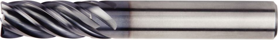

HARVI™ II • Square End • 5 Flutes • Plain Shank • Metric
HARVI™ II Solid Carbide End Mill for Roughing and Finishing of Multiple Materials
Material Number4046378
ISO Catalog IDUCDE0800A5ASAANSI Catalog IDUCDE0800A5ASA

  • Ramping: 3°Ramping: 3°
  • Tool Dimensions: Flute Configuration: 5Tool Dimensions: Flute Configuration: 5
GradeKCPM15
[D1] Effective Cutting Diameter8 mm
[D1] Effective Cutting Diameter0.315 in
[D] Adapter / Shank / Bore Diameter8 mm
[D] Adapter / Shank / Bore Diameter0.315 in
[AP1MAX] 1st Maximum Cutting Depth19 mm
[AP1MAX] 1st Maximum Cutting Depth0.748 in
[L3] Usable Length19 mm
[L3] Usable Length0.748 in
[L] Overall Length 63 mm
[L] Overall Length 2.4803 in
[Z] Number of Flutes5
KCPM15
KCPM15
  • Versatile solid carbide end mill for steels, stainless steel, cast iron and high-temperature alloys
  • HARVI™ II solid carbide end mills cover a variety of operations, including dynamic milling
  • HARVI™ II solid carbide end mills feature unequal flute spacing for chatter-free machining at highest feed rates
  • Slotting up to 1xD
