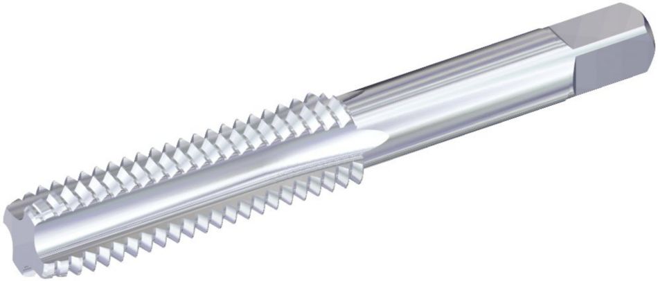

KHSST HAND • Fractional Sizes • Bottoming Chamfer
Hand Taps • Blind Holes in General Machining Applications
Material Number1542702
ISO Catalog IDKHSST08494ANSI Catalog IDKHSST08494

$41.44/each
  • HSSHSS
  • Chamfer Form: 1–2Chamfer Form: 1–2
  • Manufacturer’s Specs: UNFManufacturer’s Specs: UNF
  • Manufacturer’s Specs: UNCManufacturer’s Specs: UNC
  • Tapping Helix Angle: 0°Tapping Helix Angle: 0°
CoatingUncoated
[D1-TDZ] Thread Diameter Size7/16-20
[L] Overall Length 80.167 mm
[L] Overall Length 3.1562 in
[L3] Thread Length 36.513 mm
[L3] Thread Length 1.4375 in
[D] Adapter / Shank / Bore Diameter8.204 mm
[D] Adapter / Shank / Bore Diameter0.323 in
[Z] Number of Flutes4
Thread Tolerance Class ANSI3B
Tap Pitch Diameter LimitH3
Type of ThreadNF/UNF
