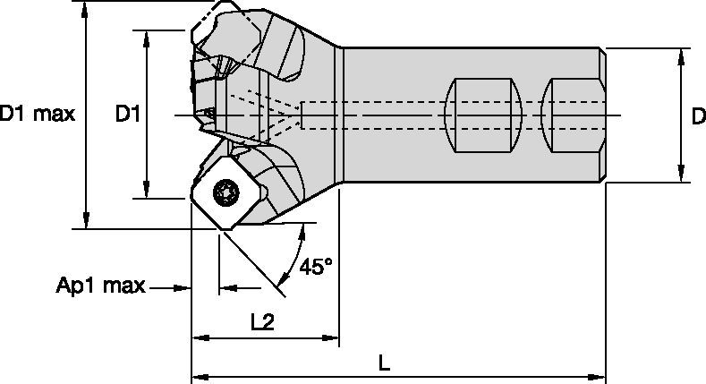

Drawings for 1817942
Material Number1817942
ISO Catalog IDKISR197SE44345M
ANSI Catalog IDKISR197SE44345M
[D1] Effective Cutting Diameter50 mm
[D1] Effective Cutting Diameter1.969 in
[D1MAX] Maximum Cutting Diameter63.88 mm
[D1MAX] Maximum Cutting Diameter2.515 in
[D] Adapter / Shank / Bore Diameter31.75 mm
[D] Adapter / Shank / Bore Diameter1.25 in
[L] Overall Length 97.917 mm
[L] Overall Length 3.855 in
[L2] Head Length 40 mm
[L2] Head Length 1.575 in
[AP1MAX] 1st Maximum Cutting Depth6.61 mm
[AP1MAX] 1st Maximum Cutting Depth0.26 in
Number of Inserts4
Weight Pounds1.62
Max RPM22500
