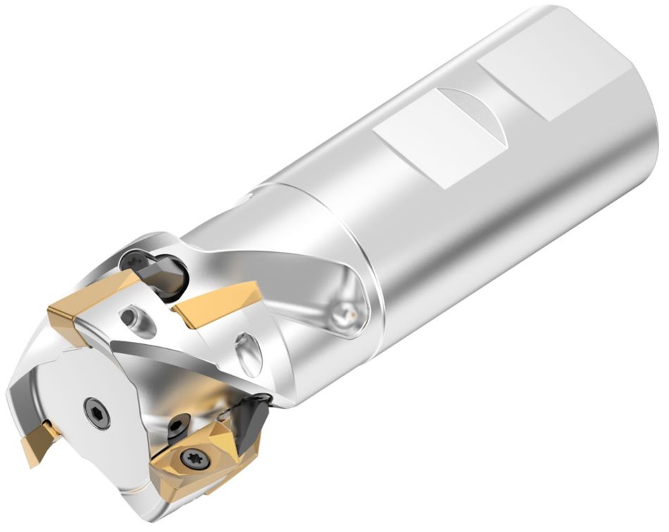

Mill 1-14™ • Helical End Mill • Weldon® Shank • Metric
Material Number3743034
ISO Catalog IDM1H40J3R65B32S90ED14C9ANSI Catalog IDM1H40J3R65B32S90ED14C9
- P Steel
- M Stainless Steel
- K Cast Iron
- N Non-Ferrous
- S High-Temp Alloys
- H Hardened Materials
- .caption
Face Milling
Helical Milling
Ramping: Blank
Slotting: Square End
Milling - Through Coolant
Shank - Cylindrical Weldon 2 Flat
Pocketing
- Overview
- Application Data
- Downloads
- Spare Parts
| Material Number | 3743034 |
| ISO Catalog ID | M1H40J3R65B32S90ED14C9 |
| ANSI Catalog ID | M1H40J3R65B32S90ED14C9 |
| [D1] Effective Cutting Diameter | 40 mm |
| [D1] Effective Cutting Diameter | 1.575 in |
| [D] Adapter / Shank / Bore Diameter | 32 mm |
| [D] Adapter / Shank / Bore Diameter | 1.26 in |
| [L] Overall Length | 126 mm |
| [L] Overall Length | 4.961 in |
| [L2] Head Length | 65 mm |
| [L2] Head Length | 2.559 in |
| [AP1MAX] 1st Maximum Cutting Depth | 40.81 mm |
| [AP1MAX] 1st Maximum Cutting Depth | 1.607 in |
| Number of Inserts | 9 |
| [Z] Number of Flutes | 3 |
| Maximum Ramping Angle | 4.8 |
| Weight Kilograms | 0.66 |
| Max RPM | 28400 |
- Steel
- Stainless Steel
- Cast Iron
- Non-Ferrous
- High-Temp Alloys
- Hardened Materials
- .caption
Face Milling
Helical Milling
Ramping: Blank
Pocketing
- Internal coolant supply.
- For ramping, slotting, plunging, facing, and true 90° walls.
