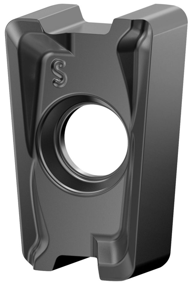

Mill 4-11™ • Carbide Insert • LNPU11-SGE • Medium Machining
Shoulder milling insert with four cutting edges per insert
Material Number6131502
ISO Catalog IDLNPU110408SRGEANSI Catalog IDLNPU432SRGE
Mill 4-11™ - Insert - LNPU11-SGE - Medium 6131502 - Kennametal
C$33.13/each
Drawings for 6131502
GradeKC522M
[LI] Insert Length 12.1 mm
[LI] Insert Length 0.476 in
[S] Insert Thickness4.83 mm
[S] Insert Thickness0.19 in
[W] Insert Width 6.6 mm
[W] Insert Width 0.2598 in
[BS] Corner Facet Length 0.9 mm
[BS] Corner Facet Length 0.036 in
[Rε] Corner Radius 0.8 mm
[Rε] Corner Radius 0.031 in
Average Chip Thickness [HM]0.1 mm
Average Chip Thickness [HM]0.0039 in
Cutting Edges per Insert4
KC522M
KC522M
Coated carbide grade with a AlTiN (PVD) coating. KC522M is engineered to provide better performance in general machining of steel, stainless steel, cast iron, and high-temperature alloys. KC522M resists breakage and offers improved wear resistance and increased strength.
  • Pressed-to-size, for lowest cost per cutting edge
