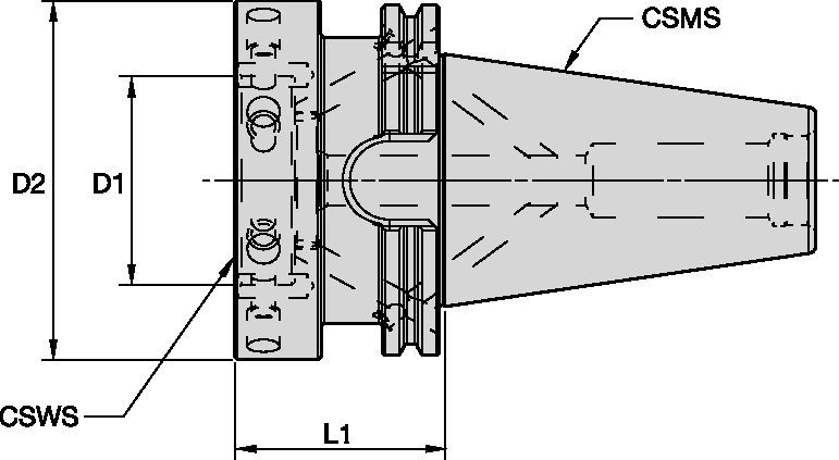

[CSMS] System Size Machine SideDV50
[CSWS] System Size Workpiece SideSIF70
[D2] Body Diameter 1 Workpiece Side 70 mm
[D2] Body Diameter 1 Workpiece Side 2.756 in
[D1] Adapter / Shank / Bore Diameter38 mm
[D1] Adapter / Shank / Bore Diameter1.496 in
[L1] Gage Length60 mm
[L1] Gage Length2.362 in
Weight Kilograms3.6
Weight Pounds7.93
