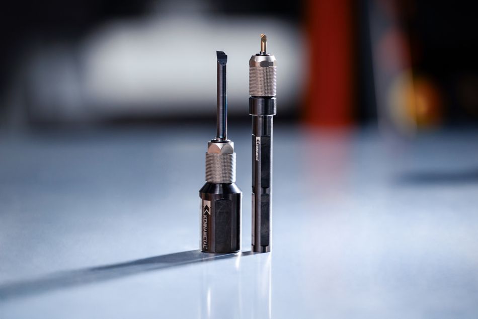

Two Kennametal TopSwiss MBS inserts in toolholders

Kennametal collaborated with the client and their local distribution representative to identify and implement a more effective solution. The decision was to use a TopSwiss™ MBS insert in grade KCSM25S along with a high-performance tool holder . This combination allowed them to significantly increase the depth of cut by 66%, from 0.005” to 0.015”.
