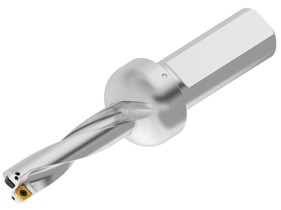

Drill Fix PRO™ • Drill Body • 4 x D • WB Shank • Inch
Indexable Drilling • Weldon® Shank
Numéro de matériel7031214
Ref. ISO CatalogueDFPR0594R4WB075Ref. ANSI CatalogueDFPR0594R4WB075

| Numéro de matériel | 7031214 |
| Ref. ISO Catalogue | DFPR0594R4WB075 |
| Ref. ANSI Catalogue | DFPR0594R4WB075 |
| [D1] Diamètre de foret M | 15.0876 mm |
| [D1] Diamètre de foret M | 0.594 in |
| [D1MAX] Diamètre de foret maximum | 15.5876 mm |
| [D1MAX] Diamètre de foret maximum | 0.6137 in |
| [L5] Longueur de pointe du foret | 0.45 mm |
| [L5] Longueur de pointe du foret | 0.018 in |
| [L1] Insérer la longueur de l’étalon | 79.35 mm |
| [L1] Insérer la longueur de l’étalon | 3.124 in |
| [L4] Profondeur de perçage maximale | 60.35 mm |
| [L4] Profondeur de perçage maximale | 2.376 in |
| [LS] Longueur de la queue | 50 mm |
| [LS] Longueur de la queue | 1.9685 in |
| [D] Adaptateur / Queue / Diamètre d’alésage | 19.05 mm |
| [D] Adaptateur / Queue / Diamètre d’alésage | 0.75 in |
| [CS] Taille de l’alimentation d’arrosage | 1/8-27 NPT |
| Plaquette étalon 1 du catalogue Face Interne | DFPR050204__O |
| Plaquette étalon 2 du catalogue Face interne | DFPR050203__I |

- Versatile indexable drill, covering many workpiece materials.
- For straight hole drilling, inclined entries and exits, interrupted cuts, and rough casted, forged or welded entry surfaces.
- Two eccentric positioned coolant channels for higher coolant volume, providing higher metal removal rates, tool-life, and productivity.
- Helical flutes for perfect chip evacuation.
- Drill body provides high stiffness, eliminating noise and vibrations, resulting in best-in-class hole size accuracy and hole quality.
- The X-offset feature enables diameter adjustment within the machine, and applications on lathe machines.
