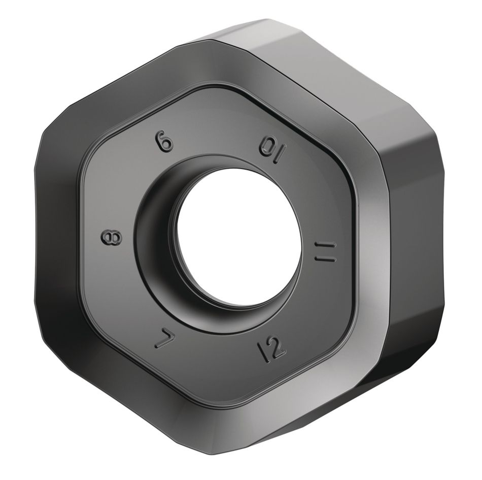

Dodeka MAX™ 45° • Carbide Insert • HNGJ-GD • Medium Machining
Face milling insert with twelve cutting edges, precision ground
Material Number100000773
- First choice for light machining.
