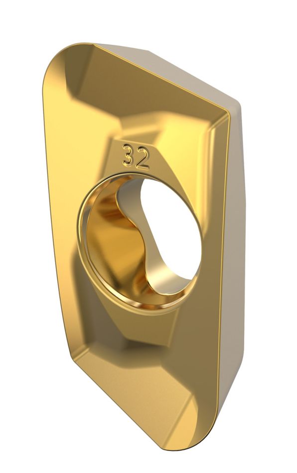

Inserts for Mill 1-18™ • EDPT-E.GD
Indexable Inserts
Material Number100000075
- Medium roughing and semi-finishing.
- Medium feed rates.
- PSTS — Precision Pressed and Sintered to Size.
- Ap1 max = .708″ (18mm).
