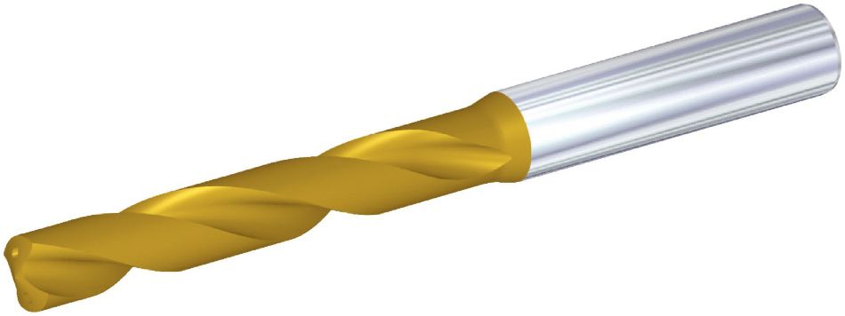

GOdrill™ • 5xD • Internal Coolant • Straight Shank • Metric
Solid Carbide Drill for Multiple Materials
Material Number4149266

Drawings for 4149266
ISO Catalog IDB052A09000CPG
ANSI Catalog IDB052A09000CPG
GradeKC7325
[D1] Drill Diameter M 9 mm
[D1] Drill Diameter M 0.3543 in
[L] Overall Length 103 mm
[L] Overall Length 4.0551 in
[L3] Flute Length 61 mm
[L3] Flute Length 2.4016 in
[L4] Maximum Drilling Depth 49 mm
[L4] Maximum Drilling Depth 1.9291 in
[L5] Drill Point Length1.53 mm
[L5] Drill Point Length0.0602 in
[LS] Shank Length 40 mm
[LS] Shank Length 1.5748 in
[D] Adapter / Shank / Bore Diameter10 mm
[D] Adapter / Shank / Bore Diameter0.3937 in
  • DrillingDrilling
  • DIN number 6535DIN number 6535
  • DIN number 6537DIN number 6537
  • Shank - Cylindrical Whistle Notch 2°Shank - Cylindrical Whistle Notch 2°
KC7325
KC7325
Composition: Multilayered PVD TiN-TiAlN coated fine-grain carbide with a TiN top layer for better wear identification.
Application: This multipurpose grade has been combined with a unique general-purpose cutting geometry to offer high versatility and reliability across all material groups at intermediate cutting conditions.
  • General purpose solid carbide drill for use across a wide range of materials
  • Marginless design reduces friction and heat for longer tool life
  • Gashing design for micro drilling ensures a free flow of chips in the center of the drill
  • Uninterrupted straight cutting lip does not allow a starting point for wear
  • Enables an even distribution of cutting forces and reduces chipping on the cutting-edge
  • KC7325™ grade contains a double coating for broad applications and a TiN top layer serves for easier monitoring of wear on small drills
